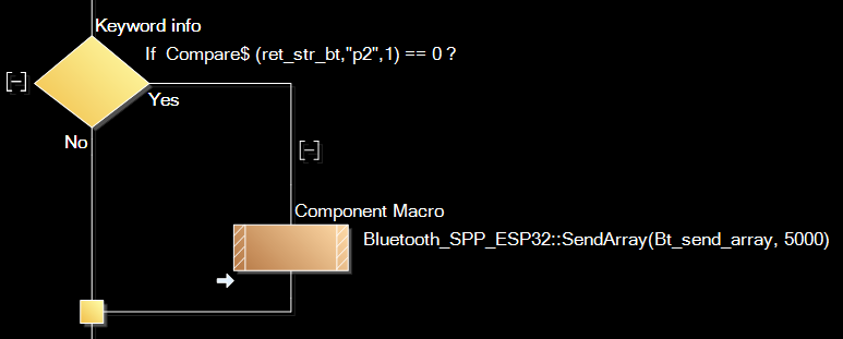

Sending a array of char is working fine even it's more than 20 byte.
I tested 512byte and it was working fine

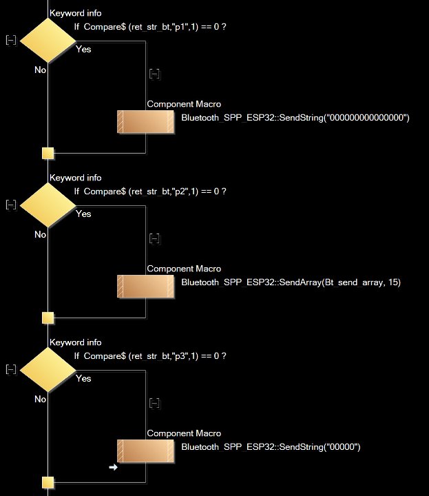

The file is changed but still a problem sending longer string. So I tried send
P1 15x char 0 //and it crashed
P2 15x byte char "0" (decimal 48) //working fine
P3 5x char 0 //working fine

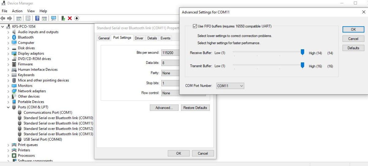

Testet on Windows and Android
