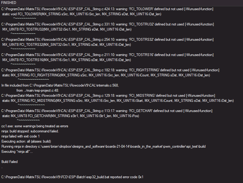

I got time to test the system and there seems to be a problem now that I have updated the components the program wont compile I have not changed anything other then update the components and I get the following error message.
error message.png (72.14 KiB) Viewed 9532 times

Please could you attach the project msg.txt file?
That will help much better than a partial screen shot

Looks like there is an issue in DSPOutput::GetFloat()
I'll leave it for Ben to look at :)
