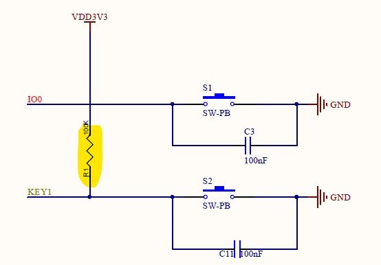

Do you have any attached circuitry?
GPIO35 has an on-board pull-up resistor, GPIO0 does not.
Also, please try with debounce set to 0

hi Ben,
yes there is 100K resistor, this is the reason why input is always to 1 when button is not pushed but didn't explain why input still at 1 when button pushed. (set to active low polarity even with debouce set to 0)
Do you explanation why both are working well with interrupt ?

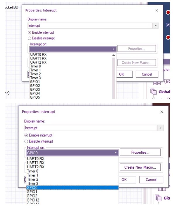

For your information
I have just added these lines to ESP32.FCDX to be able to use the INT0 too, if you want to release the new version.
Tested : Working well
ESP32 INT GPOI0.jpg (52.64 KiB) Viewed 11612 times

Re: IO14 on ESP32 TTGO display not available to read voltage
Sorry this has taken a while but I have now added the missing GPIO0 and GPIO1 interrupts to all ESP devices and also hopefully solved the IO problem you were having without needing the C icon.
