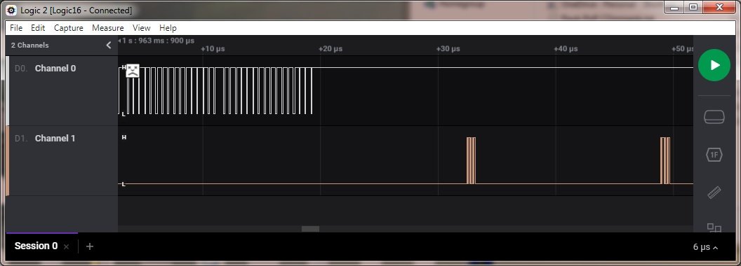

Re: Wrong delay when use "delay ms" ESP32
It's pretty much as I had imagined, the SPI is faster but the overhead is killing it.
The top trace shows the software driven display and the bottom trace shows the SPI version @ 10MHz.
I'll keep chipping away at it. :D

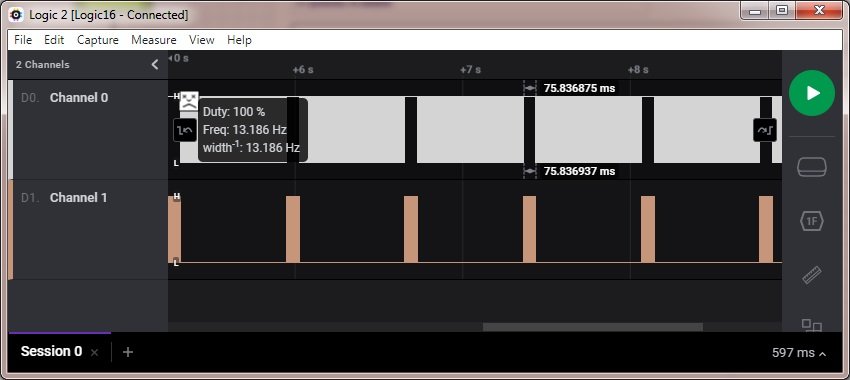

I've pushed a new version of the SPI display component which should be a lot faster.
I have a program that just clears each display version,
Using the new SPI display component the clear is now a lot faster, 630ms for the serial component vs 75ms for the SPI version @ 25MHz.
It will be interesting to see how it gets on with a test that's drawing data to the display. I've optimised where I can so hopefully it is still as fast if not faster.
