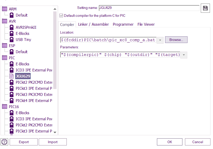

RIght I've been hunting around for a fix for this problem and it looks like it's not simple. It seems to be something deep ni the XC8 compiler that's stopping this from working. The only way I have managed to make it work is to copy and paste the compiler calls from MPLABX and this seems to have worked.
If you go to Help -> Library Updates and do a full database update then there is a new batch file available for PIC.
You can then point to this new batch file using the Build -> Compiler options
Change the compiler location from
$(fcddir)PIC\batch\pic_xc8_comp.bat
to
$(fcddir)PIC\batch\pic_xc8_comp_a.bat
Abnd click the save button at the top of the window.
Give this new setting a name and ensure that the Default compiler checkbox is ticked on the new settings before clicking OK.
Fingers crossed it should now compile and run on the device.
Let us know how you get on.

Doesn´t work, after changing according your description. when compiling it start emidiately coming with errors. Even if I try to go back to $(fcddir)PIC\batch\pic_xc8_comp.bat it doesn´t work, either if I go back to Eblock setting?
I give it up and will not more, frustrations and used so long time one this bug. I am afraid to "destroy" other thing in FC9. When I use these tiny device I may use FC5.
Is there a way I can get the "old " compiler option back in FC9 without reinstall FC9 so I am sure not have made any errors, please?
Jorgen
Jorgen

Re: Pic12629 + Pic12f675 not working!
Hi Jorgen,
Sorry I know it's frustrating, frustrating for us here too. Thanks for bearing with us while we try and work out the kinks.
I've not touched the original setting so that shouldn't be effected at all. Make sure you are ticking the Default Compiler checkbox when trying to go back to the E-block setting.
What errors are you getting? Are you using the default PIC compiler? We have two versions V7 (PIC) and V9 (PICv2) which are you using.
Can you send me your project and the .msg.txt file and I'll try and replicate here.
