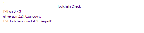

Hi, monie.
If you run an update via Help>Library Updates.
Change Files in-use to Full database, then download all the updates, within the compiler messages there is now a toolchain path check:
ESP32 toolchain check.png (4.84 KiB) Viewed 6224 times
When I had an issue on v11 it was because I tried a later version toolchain.
If you go back to the posts starting from https://flowcode.co.uk/forums/viewtopic ... 9092#p9092
Myself, mnfisher, and Steve have all given you advice that should get you going.

Please see below and the attached: Compiler Messages-18-12-2022
See the Compiler Messages errors:
Build Failed
Autoclose turned off
FINISHED
See attached file: "Compiler Messages-18-12-2022"
Can anyone here see where it's going wrong and what needs to be done!
Do you have a suggestion!
Yours sincerely
Monie
