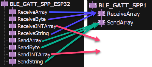

Re: FC11 ESP32-S3 BLE error

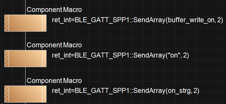

Perfect!
SendArray is working for this 3 commands
to send: as buffer as "on" or as string
That means it already works very well.
I have observed that it is already perfectly implemented in ESP32 BLE_GATT.
these practical send/receive IntArray

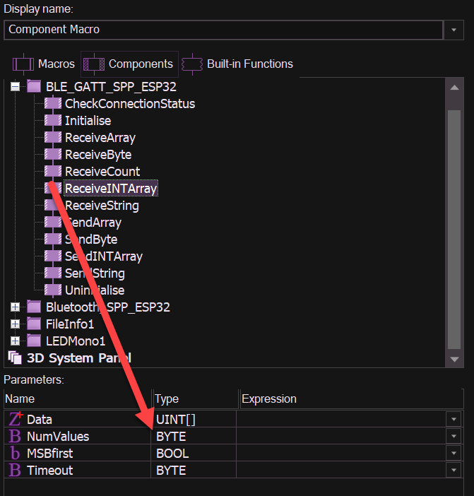

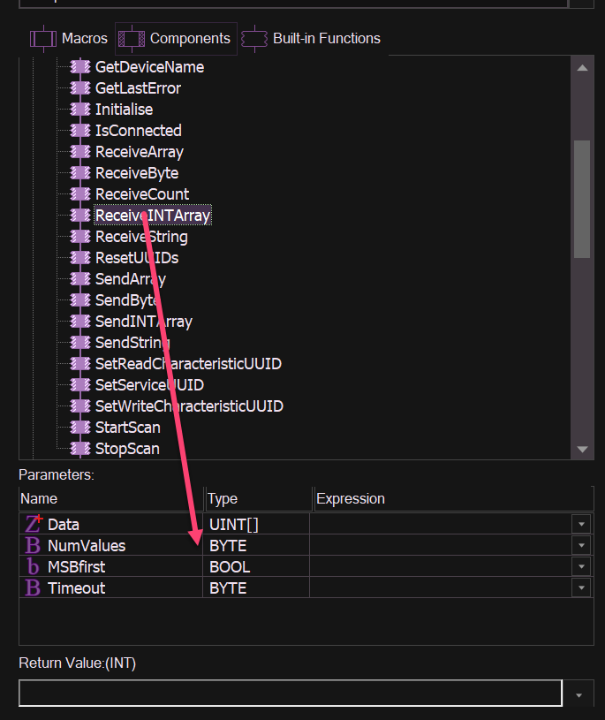

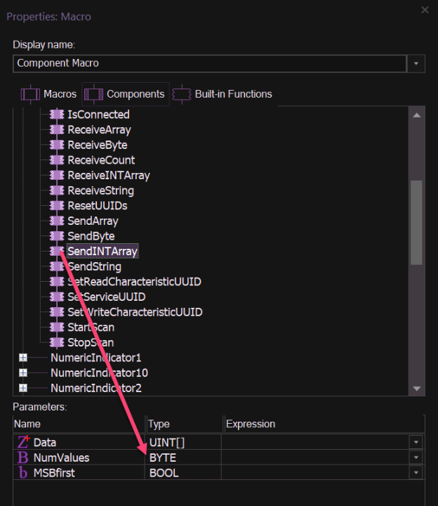

Yes RX Led is perfect!
Also the send/receive IntArray is there.
but one little thing ....
NumValues are usually int or uint
A byte has crept into these three macros.
But it's not really a problem.
Hi Stefan,
The byte is there on purpose as I have to define a byte byffer to use as a go between to convert from bytes to ints and that is fixed at 512 bytes and so more then 256 values in the array would require a bigger buffer of unknown size. It's a compromise but seems to be what I have put in place in the other components that work with arrays of ints.
I cannot locate the comonents in the web developer.
I'm on it, I think we have already released the web developer version of a component
Posts: 2305
Has thanked: 637 times
Been thanked: 847 times
Ok it looks like it might not be released yet.
I'll talk it through with Steve when he's back and see if we're happy with it. Currently it only deals with Strings so probably needs more effort puttin in to match up with the other components.
