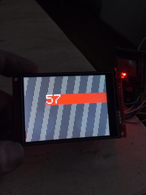

It was on yes, but when I set to No, something happend. Picture is comming but background is striped and is still slow... No change in prescaler..
Jorgen
Jorgen

Right finally managed to find some more free time to have a go with this and have managed to get the SPI component working again and pushed the speed right up.
For me it's working with a SPI frequency of 30MHz. 40MHz seems to kill it but that's maybe down to the length of my wires.
There are maybe further optimisations to make for example the clear is very fast but drawing large filled rectangles can be seen being coloured in, however this is hopefully now more down in the detail.

I have update and perform a test. Now there is no stripe´s on the display anymore and look good, and the speed is a little faster, but slow compared to the seriel mode. I try to change the speed up to 80 mHz and toogle the CS, no change.
I att. my testprogram with Seriel and SPI. You can switch in the Macro in Main.
If you still are very busy, then don´t use more time for that, the seriel is fast, and can live with that, but again when I see on Utube the ILI9341 it is really fast
Could be nice i FC9
EDIT: Ben, you are a master
I switch from software to Channel1 "Oh my good" First test the display is so fast it is almost jumping over my table
WOOOOOW. Nice job.
I try to make some more test and stress the display, thank´s . You hear
Br jorgen
