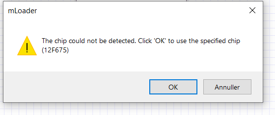

*If you're using E-blocks to host the chip then be aware that most of the pins are on the E-blocks PortB and not PortA.* Try, but only see Port A on output?
Honest I have not testst yet, but should it also work for the 12f675?

To fast for joy?
****Edit Ben let it be, I can now program the 629 + 683 + 615 devices, enough for me with these tiny devices****
