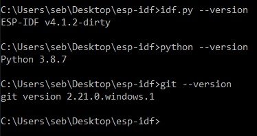

FAILED: esp-idf/main/CMakeFiles/__idf_main.dir/esp-project.c.obj
ccache C:\Users\seb\esp-idf-tools\tools\xtensa-esp32-elf\esp-2020r3-8.4.0\xtensa-esp32-elf\bin\xtensa-esp32-elf-gcc.exe -DHAVE_CONFIG_H -DMBEDTLS_CONFIG_FILE=\"mbedtls/esp_config.h\" -DUNITY_INCLUDE_CONFIG_H -DWITH_POSIX -Iconfig -IC:/Users/seb/esp idf/components/newlib/platform_include -IC:/Users/seb/esp-idf/components/freertos/include -IC:/Users/seb/esp-idf/components/heap/include -IC:/Users/seb/esp-idf/components/log/include -IC:/Users/seb/esp-idf/components/lwip/include/apps -IC:/Users/seb/esp-
ESP32_Config_WifiV3.3.msg.txt
(219.79 KiB) Downloaded 581 times
versions .jpg (16.65 KiB) Viewed 6574 times

Very odd, you have a different error now.
error: 'FCM_HourResynchronize' undeclared (first use in this function); did you mean 'FCM_HourResyn'?
Which implies you have macro/function HourResyn, but are calling HourResynchronize?
Any corruption on your hard drive, or out of space? Or a networked drive having problems? (try C:\tmp)
Any other thoughts on what has changed since the project last compiled OK?

hello,
yes you are right, I used the wrong version.
but I made test
Based on a quick look at the ESP32 forums, could you try moving your project to a directory with a shorter path, e.g. G:\tmp
with previous one and it's same.
I'm now making a complete new install
thx
Seb

I have just made complete new install with this versions of Python, Git and idf.py
C:\Users\seb\Desktop\esp-idf>version
C:\Users\seb\Desktop\esp-idf>python --version
Python 3.8.7
C:\Users\seb\Desktop\esp-idf>Git --version
git version 2.30.1.windows.1
C:\Users\seb\Desktop\esp-idf>idf.py --version
ESP-IDF v4.3.2
All is working well for the moment. Even after menuconfig.
Thx to everybody who tried to help me to solve my problem.
You can check your versions in 1 time by added this file in the esp.idf directory, then replace .txt by .bat
Then open ESP-IDF cmd and type
version
