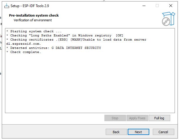

Meldung 1.jpg (32.54 KiB) Viewed 11345 times
Posts: 2418
Has thanked: 772 times
Been thanked: 831 times
Re: Problem with the installation ESP32
Hi.
That is caused by installing a later version than stated within the ESP32 Toolchain Installation guide.
Toolchain from the ESP32 site for some odd reason shows v2.3 within the file name, but as you can see it's v2.9
Can you completely uninstall your current version and delete the ESP folders.
Download the toolchain from here
It might be best to disable AV, in case it interferes with the install progress.
Follow the ESP32 Toolchain Installation guide step-by-step and select the nearest version the guide states and not the latest versions.
I installed 4.1.2 release version.
If that is not available, then anything that has 4.1 in it.
4.1 release branch should also work if 4.1.x release version not available
Also, delete the new folders that are created when you compile a project.
There are normally named the same as the project folder but will have underscores.
You can also try restarting your PC after installation.
