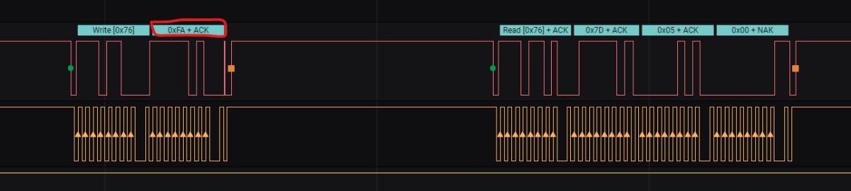

I checked with logic analyser and it show that BMP280 component is reading both Pressure and Temperature when request is to read pressure only. But only pressure data are store.
Pressure read.jpg (34.58 KiB) Viewed 8463 times
Pressure R.jpg (17.21 KiB) Viewed 8463 times
while for the temperature it is good, only the temperature is read.

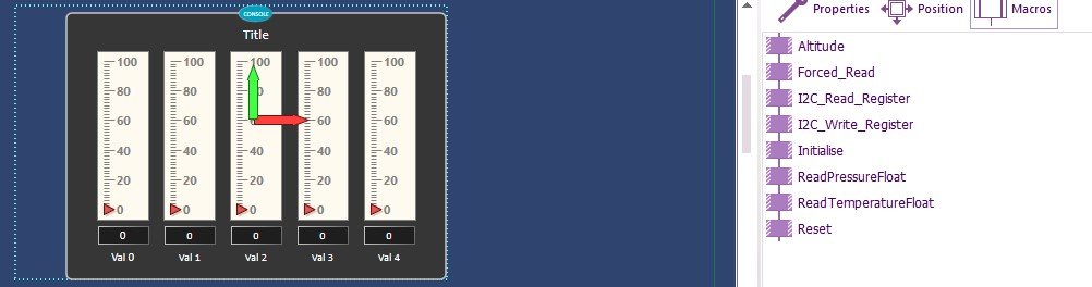

It work's but why there is 5 Val now?
5 Val.jpg (37.72 KiB) Viewed 8455 times

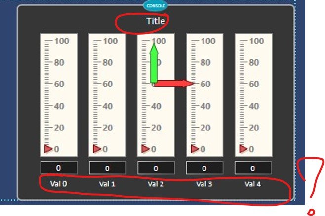

As you can see on the picture I sent to you there is 5 Val form Val0 to Val5, why ?
5 Val.jpg (44.89 KiB) Viewed 8446 times

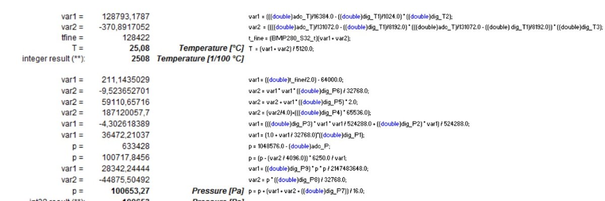

You are right kersing, to calculate pressure, need Temperature too.
So finally need both pressure and temperature to calculate pressure !

Thanks Jac.
Thinking about it pressure is related to temperature, so it makes sense to keep it in.
5
That is odd.
I did not change it from how is was.
I'm looking into it.
