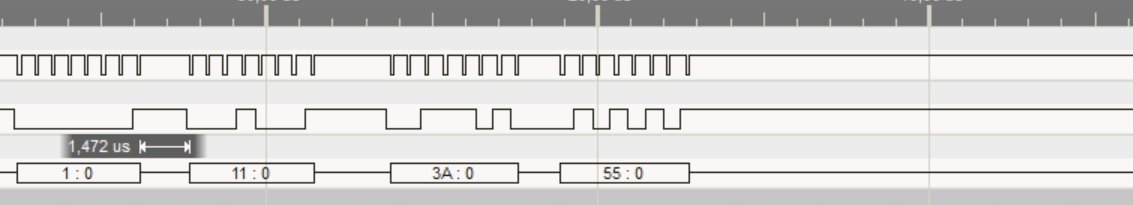

If I use the PIC32, the MCU sends the following command immediately after the SWRESET (01h) and SLPOUT (11h) commands during initialization. For some reason, there is no delay after the first two instructions. There is no time left for the display to process these instructions. The display isn't working.
For STM32, there is a pause of about 150 ms after the SWRESET instruction and about 500 ms after the SLPOUT instruction when the initialization component macro has run. The display is working.

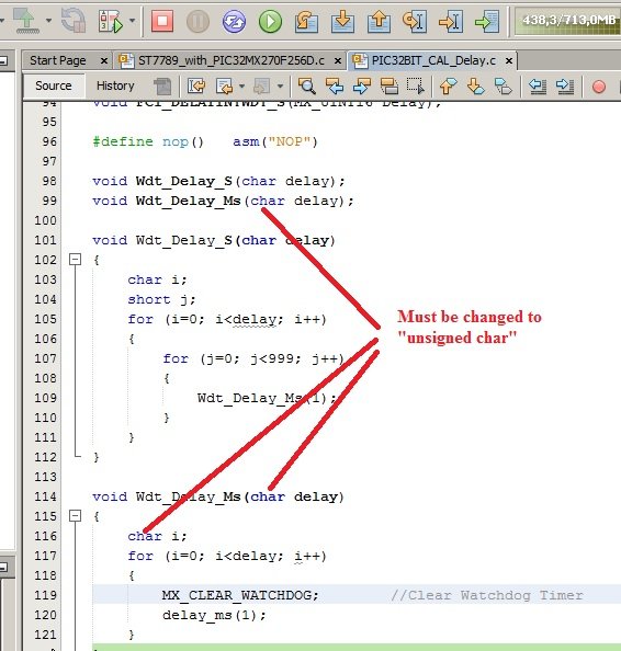

The source of the problem is in the "PIC32BIT_CAL_Delay.c" file.
Works fine after the next modification.
(Thus, the "DELAY command" will also work if the "delay value" is greater than 127 ms.)
Please fix it.
