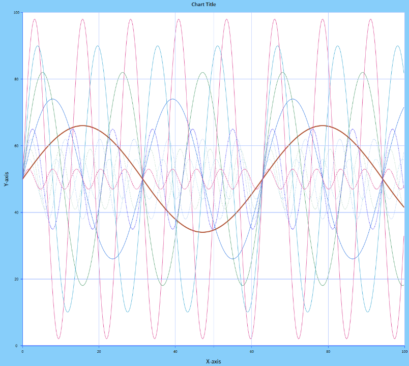

App Developer XY-Chart add few more series
Would it be possible to have a few more series for the XY-Chart component? 10 instead of 8 would be good, 16 would be great. With 16 series, the chart fits to the DSP Multiplexer component.

Re: App Developer XY-Chart add few more series
It could be done, but at the moment this would be quite difficult. I will have a look and see if there is any way to make this easier.

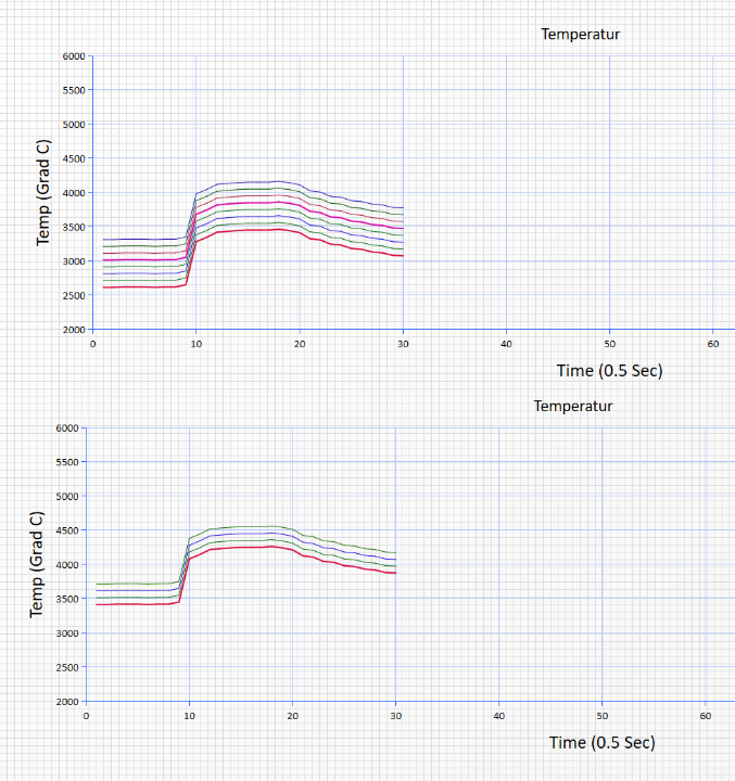

Flowcode v10 Re: App Developer XY-Chart add few more series
Hi Stefan,
If you need more traces on a chart, then you can use 2 charts as in the attached example.
The two charts are in the same location and one of them has a transparent background, so it will look like there is only one chart. You can use this trick to have as many traces on chart as you want.

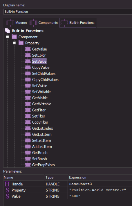

can i set parameters with a build in function (command).
like this example :
Posts: 2061
Has thanked: 311 times
Been thanked: 479 times
I'm not sure. There are dedicated functions to reposition components. What are you trying to achieve?

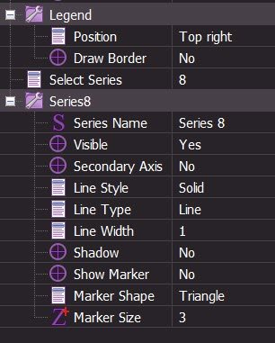

Why can I only choose 5 series and not 8?

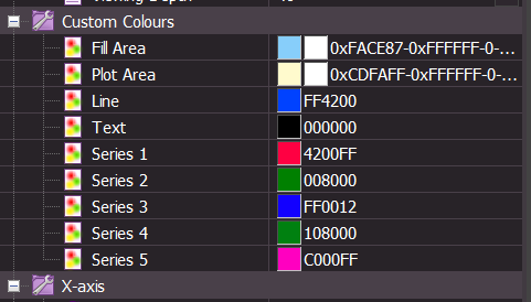

stefan.erni wrote: ↑
Thu May 30, 2024 4:59 pm
can still ask something unimportant.
We use a 3rd-party graphing tool within Flowcode for this and that is limited to 5 different colours for the traces. So trace 5 must be the same colour as trace 1, etc.
This can be overcome using that overlapping chart trick. BTW, you could have more than 2 overlapping if you needed. But lots of traces on the same chart can be difficult to view for the user.

Posts: 2061
A lot of the old object move function calls are not yet implemented for the 2d panel, so I would suggest making objects visible or invisible instead of actually moving them on the panel programmatically. This allows you to be more precise with their positions too. See the attached for an example.
