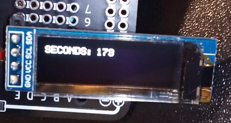

Would it be possible to get a copy of the SSD1306 I2C Component code to adapt it to 128x32 pixels?
We are using a 0.91" OLED 128x32 pixels with SSD1306 controller in I2C mode.
When I configure the component to be 128x32 pixels the program does not compile and throws an error.
Changed back to 128x64 and compiles fine.
Thanks for your help!

Many thanks for the spot.
I have created a fix for you to try.
Browse to this location using file explorer, it's hidden by default so just paste the link into your address bar.
C:\ProgramData\MatrixTSL\FlowcodeV9\Components
The flowchart will need to be refreshed if Flowcode was open when you replaced the file.

Hi Martin,
Thanksw for the swift reply and fix. It works perfectly well now
Many thanks again, enjoy the rest of the weekend.
