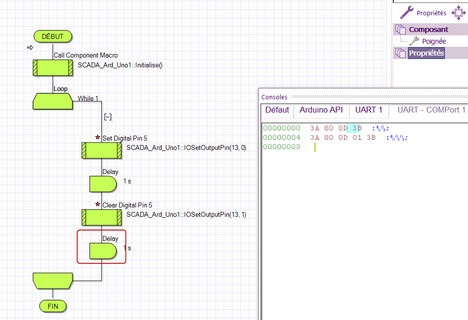

I have a problem app developper for arduino uno (SimpleArduinoUnoDemo.fcsx) for the control of inputs / outputs. The example of the control of the led 13 does not work with flowcode but works with a terminal; the firmware (Arduino Uno API Firmware.fcfx) flashed in the uno board is thus, as for him, well functional.
It seems that the data "0x00" is not correctly sent to extend the led. On the other hand the card receives the data "0x01" to turn it on.
Best regards
Bruno
Screen Shot 04-05-22 at 02.12 PM.PNG (80.37 KiB) Viewed 4449 times

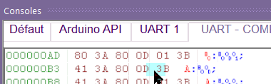

Hello, I just tested your example file and it works: great (without changing the firmware in the arduino since it worked with an external terminal) . Then I test the previous version of the example file and it works too!!! I don't understand! In any case in the window "UART -COMPort1", we do not see the sending of the code '00' between the two codes 0D and 3B for the two example files
Screen Shot 04-07-22 at 08.43 PM.PNG (10.94 KiB) Viewed 4409 times
