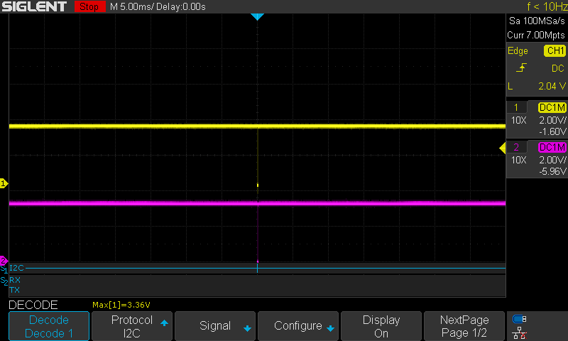

Simple program attached. Works fine in Software mode target slave address is 0x88 (note the time base on the scope is 5ms per divison = THIS IS WEIRD, it's way too slow)

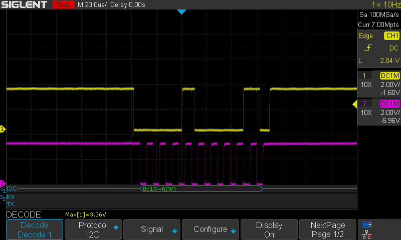

Now same component also at 100KHz, only in I2C Hardware mode (Channel 1 or Channel 2 produce the same problem)
When I zoom into the signal, I see just rubbish data:

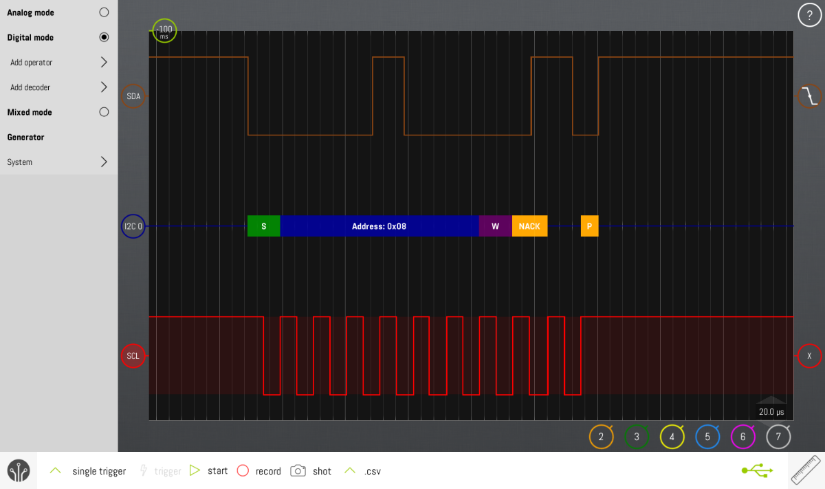

Just tested this on a wroom board and the output of the address looks okay... If there is nothing attached to the i2c then the data isn't sent (no ACK is received)
I added a loop to repeatedly output to i2c
Shows the address byte - I'm not expecting data (no ACK)...

Thanks for your efforts. Have you tried the same GPIOs I've used? If I use software mode all works fine with the slave address 0x88 I am using.
R

I used the pins as per your example (A25/B0 from memory) - and address of 8 (also as per example). I don't think the esp32 allows 'any' pin to be used - check on the uart output (@115200) - errors will get displayed if you've used an invalid combination. it 'might' be possible via the config to alter this ??
Do you have something attached to the i2c bus? - as mentioned no data is sent if no ACK is received.

Re: I2C on ESP32-WROOM-32 BUG
Thanks Martin,
I don't get any errors on the console... strange.
The scope capture is single shot of the first frames sent, so def. a bit weird that output...
I also have nothing else on the bus, I reckon the WROOM32 board has an issue, I have plenty of them, so will try another one and get back with the results.
