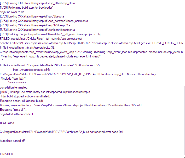

today, after library update, i test some very little program to test ESP32; using bluetooth SPP ESP32 i have this compiling error: something is missing?

I beleive this thread should help.
viewtopic.php?f=5&t=16
Which target device are you using?

i see: after corrections compiling is ok but BT not work; I use ESP32 DevKits.
