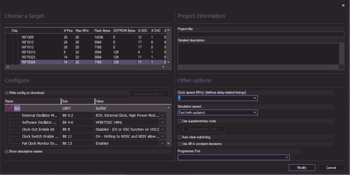

In configurations (Build > Project Options) you have Port A5 set as "External Clock In". That's probably your problem.

Thanks for the Reply
I believe I have that disabled.

OK
Cancel that.
I had the CLK out Disabled.
I diabled the Clk in and it works fine.
Thanks for pointing me in the right direction.
