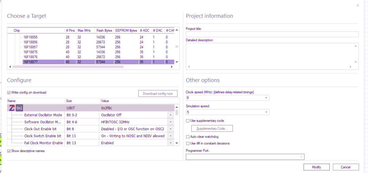

In Project options for pic16f18877 I have set it up as shown in attached image.
please advise why 32mhz does not appear in project simulation oscillator speed

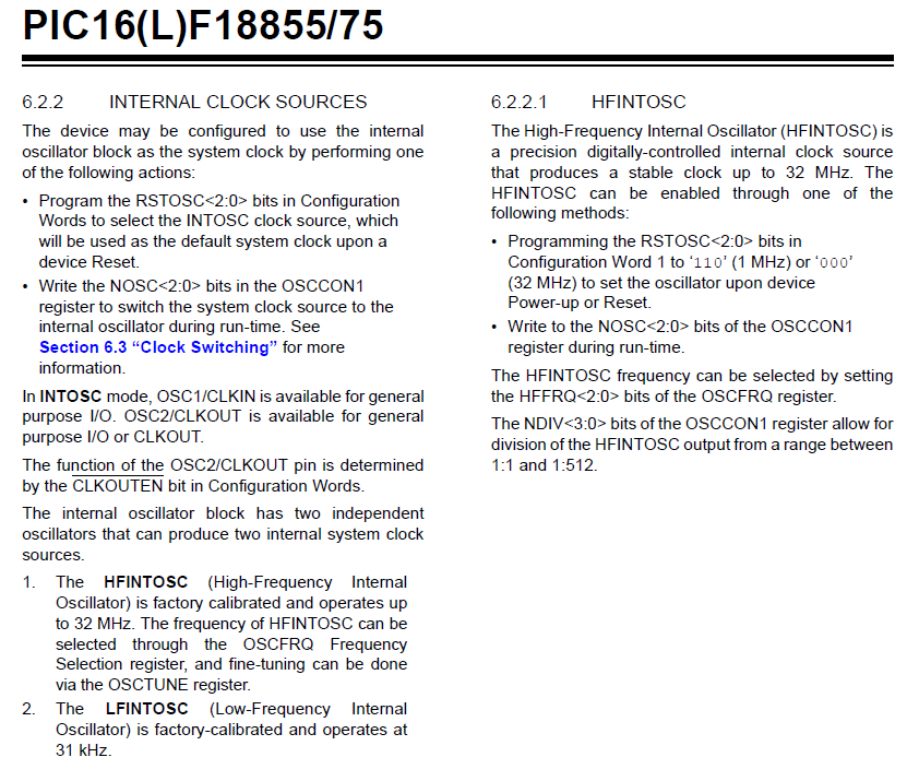

The data sheet says the HFINTOSC can run at 32Mhz as shown in attached image

You can enter your own value in the click speed settings. Just type the number you want.
