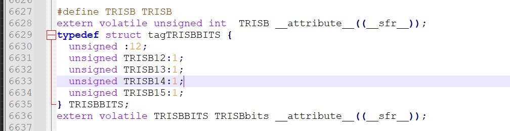

Extract from the PIC24FJ256GA702.h file that Flowcode installs. TRISB port declarations in the PIC16 toolchain currently.
Part support version 1.26.A(19-Feb-2016) Missing declarations.

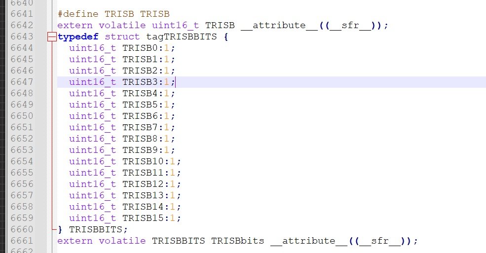

Extract from the PIC24FJ256GA702.h file that XC16 installs. TRISB port declarations in the XC16 last version.
Part support version 2.00.A(24-Jan-2022) Correct declarations.
