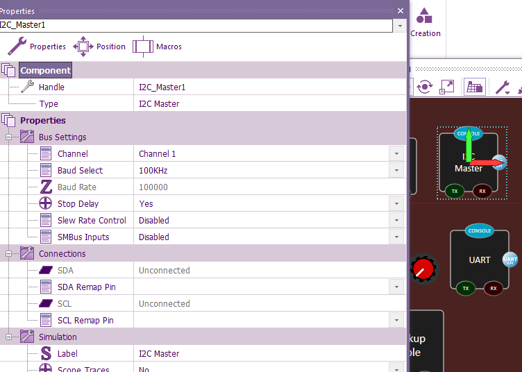

Posts: 2426
Has thanked: 778 times
Been thanked: 839 times
Re: Compiling error after changing from FC7
Hi Howard.
It was what I had suggested :
I2C unconnected pins.png (56.43 KiB) Viewed 11740 times
^ (192) undefined identifier "tris"
usually means there is an unconnected pin.
I selected 2 pins. one for SDA and SCL and your flowchart compiled for me.
