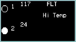

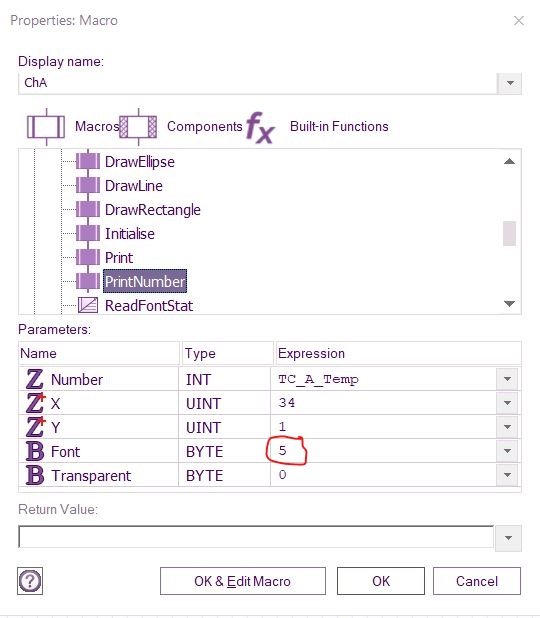

I started a project in Flowcode v8 using the gLCD SH1106 I2C Component
which displayed the chosen font size correctly in both simulation and hardware.
The same project in v9 does not display font sizes correctly.
Changing the font size in the gLCD "PrintNumber Macro" has no effect in simulation or hardware.
Project is running on a PIC 16f1788 32MHz clock.
Please assist

In FC9 it is on a new way to change font. Now you can choose different font and also the size. Ben give a very good explanation here:

Yes Font parameter now should be set to 0 (assuming you want everything in the same font) and you can use the SetFontScaler function to set the X,Y scale of the font before printing. Default is 1,1.
Sorry for any inconvenience but hopefully the new way of doing things is a bit more useful once you get used to it.

All works well once more.
The v9 gLCD font setup is a lot more flexible than previously.
Thanks again for your assistance Ben & Jorgen
