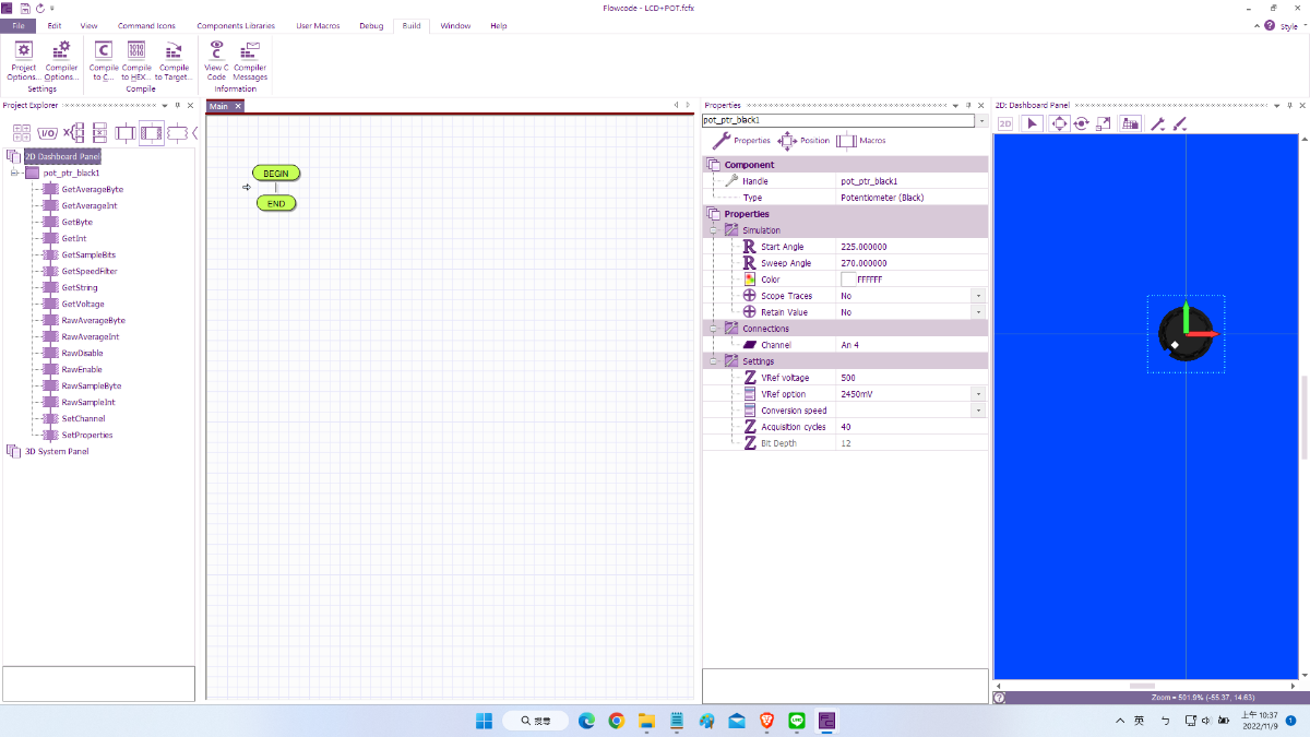

I try to built a ESP32 + Potentiometer but fail.
I found it can't be compile once I add Potentiometer even only one component on board.
(Also found the conversion speed null item inside properties setting.)
Any Idea? Did I miss something?
ESP32 + Potentiometer (fail to be compile)

- flowcode9 screen

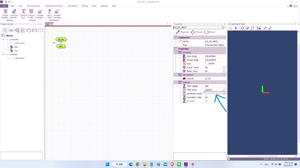

I guess my ESP32 toolchain install should be ok due to other ESP32 works fine, just can't use any ADC components.
I found I can't set the timing (speed). Is that a issue?

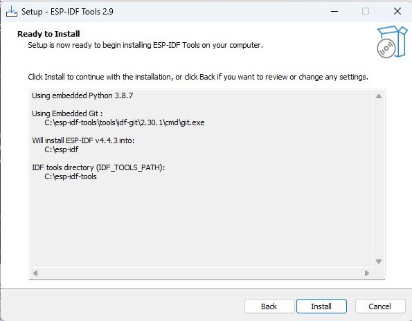

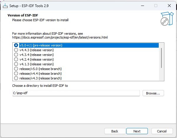

I try many time with many different version of ESP toolchain. And totally damage the compile function for ESP32 in my Flowcode....It can't be compile
ESP32 any more... sad.
There are no 4.1.2 (release version) from "esp-idf-tools-setup-2.3.exe" any more. And I can't skip python option even I install 3.7 already ( it install 3.8 automatically )
What should I choose, any suggestion?

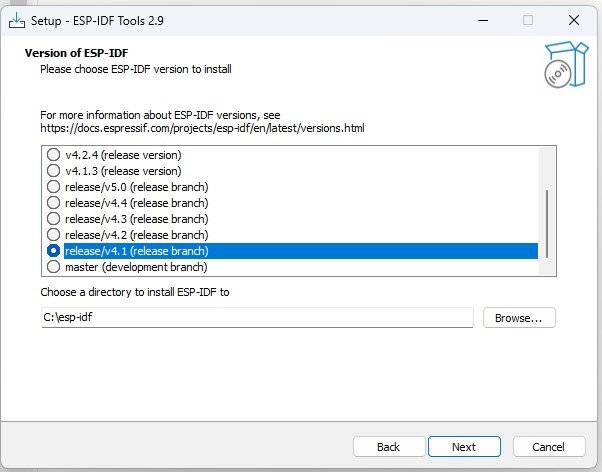

Yes, Ben.
I am install the toolchain from here : "https://www.flowcode.co.uk/download/fil ... up-2.3.exe" but no 4.1.
There are "4.1.3 (release version)" <--- Do you mean this one?
Or "release/4.1 (release branch)" <--- Or this one?

Re: ESP32 + Potentiometer (fail to be compile)
Hopefully either should be ok. We have thoroughly tested the 4.1 version.
Just having a look to see how the adc calls have changed and see if we can rework the code so it works with both.
Edit, I've made some changes to the code and pushed the latest version and hopefully this will allow the later version to also compile. Please note I've tested 4.1 still compiles ok but not tested the newer version just yet.

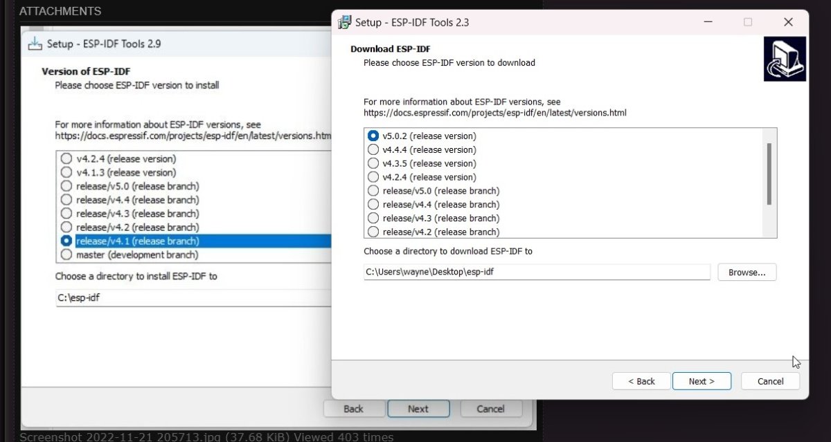

Hi Flowcode team,
I still having problems getting esp wifi kit 32 to compile and was told to install the toolchains with 4.1 of IDF esp but do not have the option of 4.1 or 4.1.3 this is all of the option given to me.
Thanks,
Wayne m
Thanks,
Wayne m
- 2023_05_12_14_48_44_Greenshot.jpg (88.74 KiB) Viewed 9910 times
