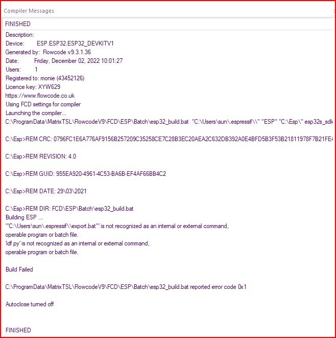

I have just tryed to install ESP toolchain and have follow the guide. When I compile to the target I get this error message, How can I solve this?

Re: ESP toolcain!
Hi!
I have now tryed to uninstall and reinstall the EspToll chain several time, I follow the guide step by step, still not possible to compile.
I have guide the parh via Wiev>global setting >location. Same error every time. Please help.
Monie

The esp tools don't look to have installed correctly (export.bat and idf.py not found). If you try from a command line (Windows key, cmd) - have a look in the esp directory (which FC has as users\sun\.espressif\)
If there is a file 'install.bat' - try running that (so from command line just cd to the install directory and then type 'install' (without the quotes)
It's definitely a black art getting a setup working - I had to run the installation multiple times - so once you have it working make a backup!

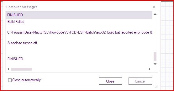

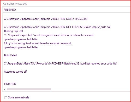

Re: ESP toolcain!
Hi Steve/Martin!
First I uninstall ESP and Pyton. Then I install the Steve´s version of ESP NOt help. THen I try to run Martin´s advice to install from ESP-4.3 CMD
same error. Could i be my Antivirus program ESET Internet SECURITY ?
Please.
Monie
Please.
Monie
