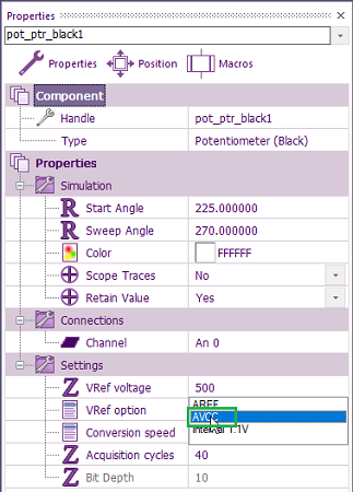

I set potentiometer connect to A0 with GETBYTE and decision IF Getbyte>128 LED TurnON
When simulate its is OK but when to compile to target, LED always turn on ???

An issue like that is when the potentiometer VRef voltage properties is set to vref+ instead VDD and Vref+ pin is left floating.
If that is not the case can you post your project file that has extension .fcfx

I have modified your project by changing Vref option from the default AREF to AVCC.
Changing Vref option.png (78.27 KiB) Viewed 6466 times
Additionally, I have increased the conversion speed to Fosc/128 for extra stability.
I have also added a note on wiki for each potentiometer.
