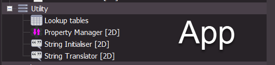

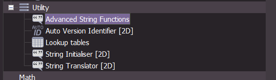

Posts: 1290
Has thanked: 246 times
Been thanked: 257 times
Re: Webserver SetOutValueArray
It' looks good. Just it's missing for the App Developer.
And the Auto Version Id would also be something for the app developer?
and something else I miss is command which can convert a byte, integer, float into a string with leading zeros or space.
This might also go into the Advanced String Function?
Posts: 2309
Has thanked: 642 times
Been thanked: 850 times
The component should be there for AD now. We are investigating adding the auto version component, it's a bit trickier but we have a plan on how to do it.
The formatted strings is a good idea. I'll have a think on how to add it.
edit - now added the formatted strings :D

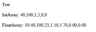

Posts: 2309
Hi Bob,
This should do what you're after. Make sure you do a full database library update to get the Advanced string component.
WebArrayIdea.fcfx
(17.24 KiB) Downloaded 580 times
RGV250
Posts: 458
Has thanked: 46 times
Been thanked: 48 times
Post by RGV250 »
Hi Ben,
A big thanks for that, I can understand what i going on where i did not have a clue with the other example.
I will have to wait until the weekend to try it on my laptop which has the external web browser example. For some reason I am still having an issue with simulating that on Win 7 an the https problem. Probably need to change the IP address.
Bob
