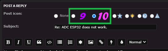

If you have any issues with Flowcode V9 or V10 then create a new topic and assign the correct icon
Flowcode support.png (15.67 KiB) Viewed 3360 times
and the issue will be looked into.
