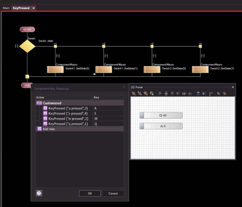

Re: App Developper: switch on keyboard
I have another solution that does not need an additional component or code. Use "Key mapping" which is available in the "Edit" menu. Attached is an example, which also uses the new "Macro called" feature of switches.
button press app.mscada
(4.32 KiB) Downloaded 435 times
button press app.fcsx
(15.05 KiB) Downloaded 454 times

Hi Martin, Hi Steve
I have tried the example from the wiki but it does not work properly.
up/dwn moves the position of the button. I did not manage to correct this, but then FC10 froze.
I have understood and modified Steve's example and it works fine.
Thanks to both
