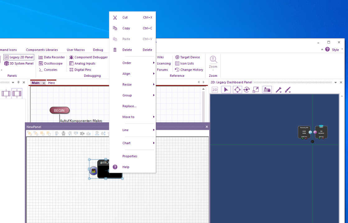

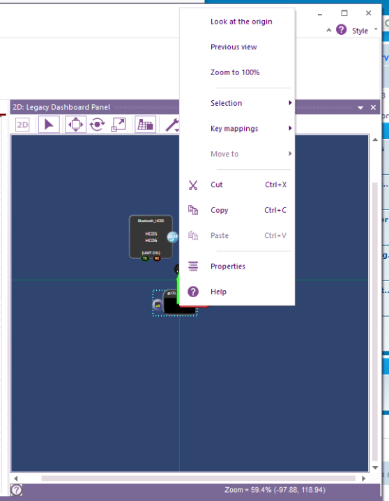

Definitely something funny going on.
If I open your chart and right click on any of your components, I don't get an option to delete (as well as a few other options)

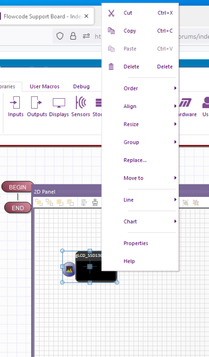

If I open a new project and add in your component then I do get expected options.
Screenshot 2023-03-24 161459.png (80.63 KiB) Viewed 5437 times
I see you are using the Lagacy 2D panel in your chart, so I added a New 2D Panel, then cut n paste'd your display and I get expected options when right-clicking.
Screenshot 2023-03-24 162257.png (239.5 KiB) Viewed 5437 times
What happens if you create your chart only using the New 2D?
