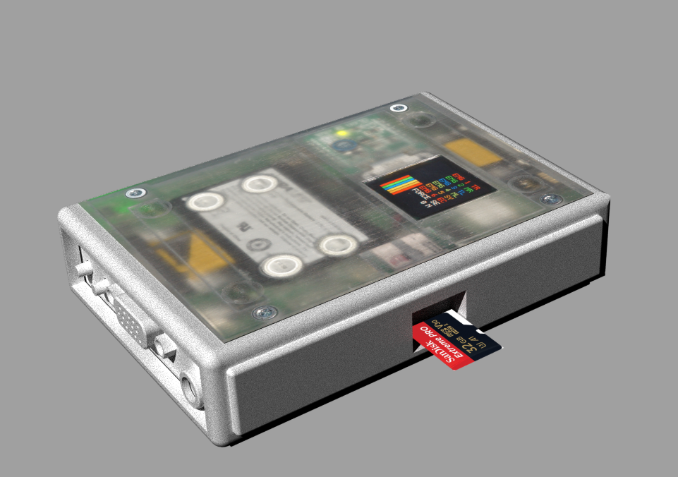

The Signal for this both Monitor is sending by bluetooth with a small device programed also with Flowcode and PIC32 / RN4677.
If i use FC10 App in debug mode the transmited data is faster than in the deployd mode.

Mobile recorder with micro sd-card and Microchip RN4677 BT Modul

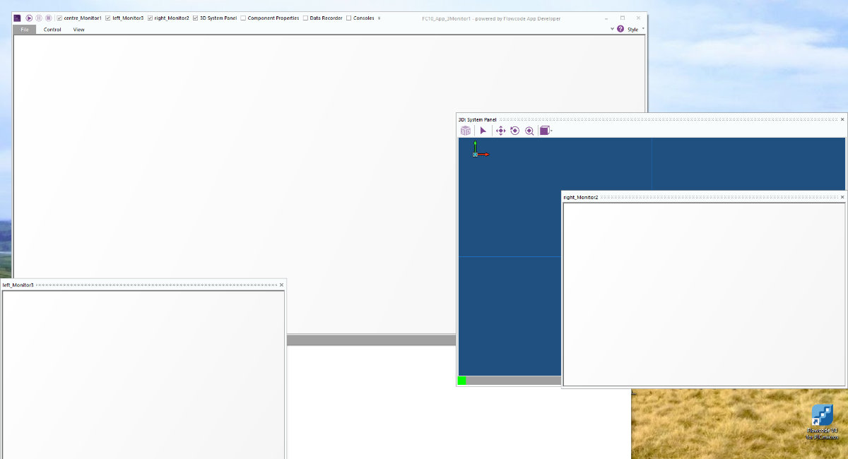

Here's what that app looks like when I open it on my PC with 1 monitor. With 2 monitors, one panel is on the left and the others are on the right.

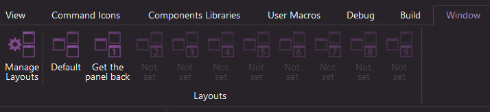

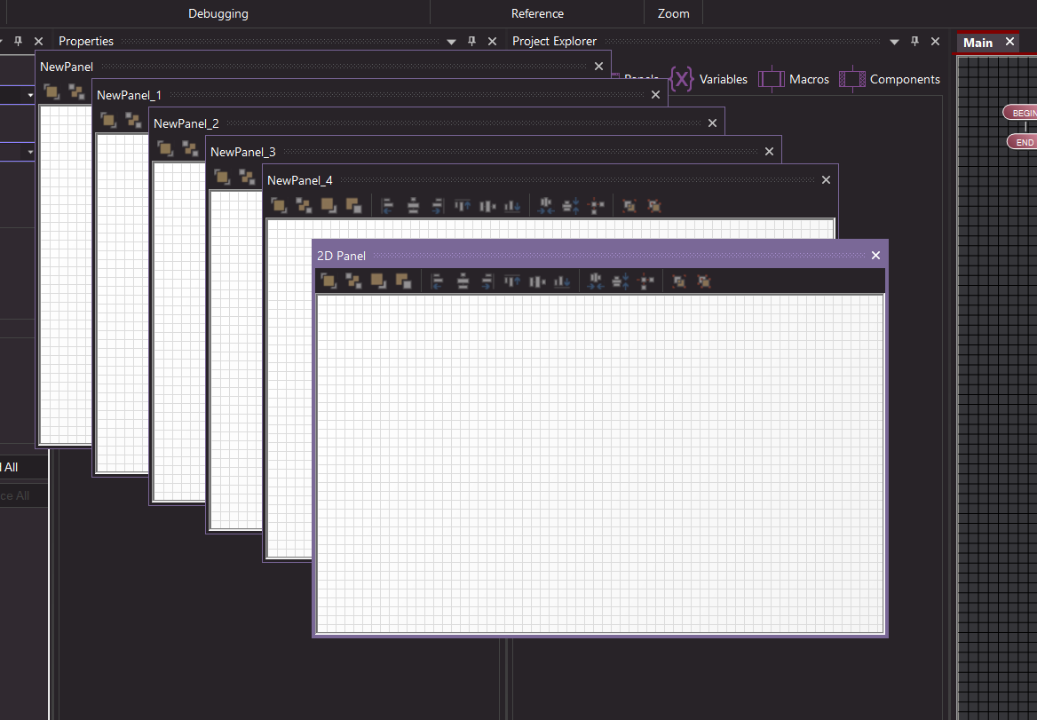

For the program mode I found a way to get the panel back and before I deploy a have the press this button ....
make a new App with some panel nicely arranged:
got to windows:

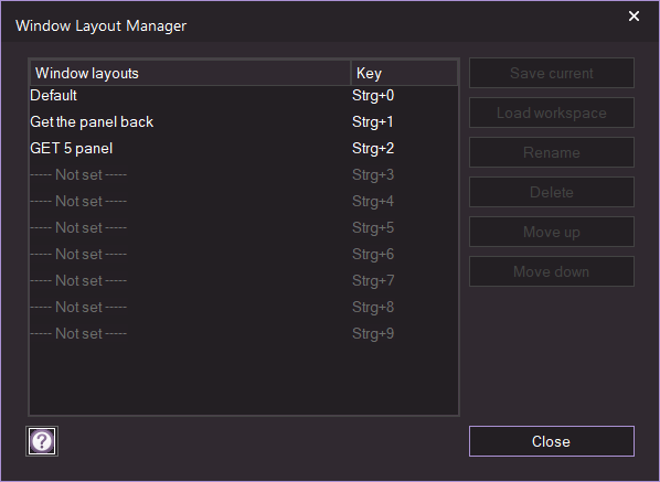

use Layout manager and save a preset:

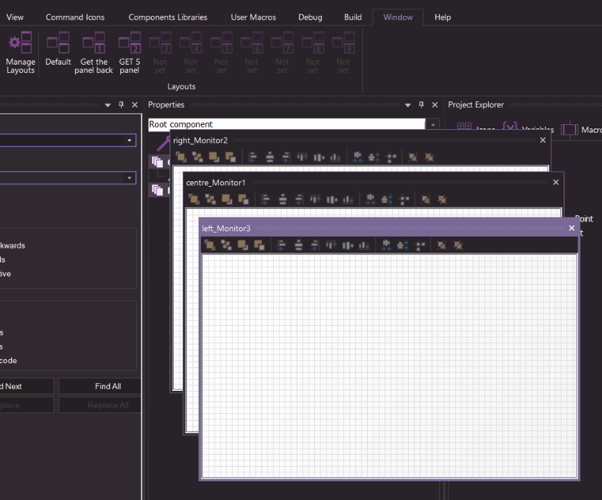

open the program with the missing panel and press get 5 panel and all panel are back:
a little strange, you can not yet touch the panel... but once again open/close the layout manager then you can use the panels nice again:
Posts: 2061
