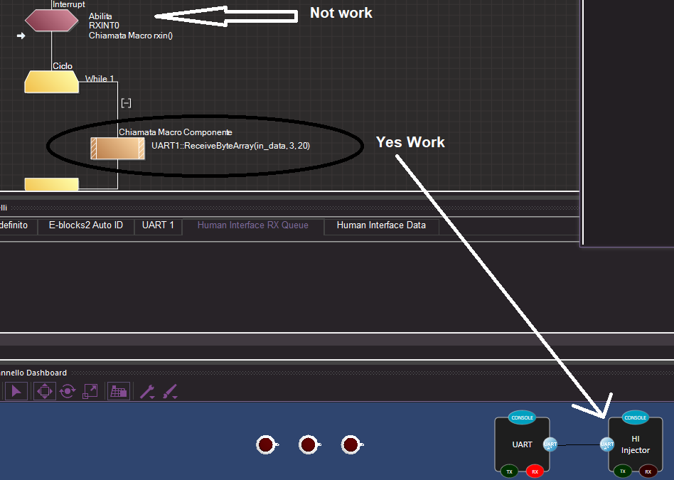

Hi I made a simple uart program and an interrupt on rx, then I entered humaninjector and readbyte only etc. it works but the interrupt doesn't fire, am I doing something wrong?

The RX interrupt does not simulate but it should work on your hardware.
Also, the Circular buffer is great when it comes to reliable communications.
So, I have attached a project for you to try.
It uses a circular buffer component and allows you to use HI injector without interfering with your hardware.
As it's not a bug but known not to simulate, I'm moving this topic from bugs.
