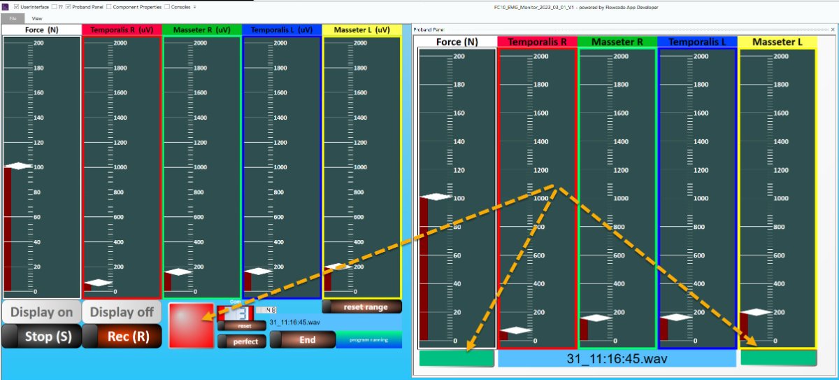

With the update there is a problem with 2D panel redraw
2d panel now redraws parts of panel to avoid unnecessary flicker of wndHost primitives
I suspect I had never a flicker before....

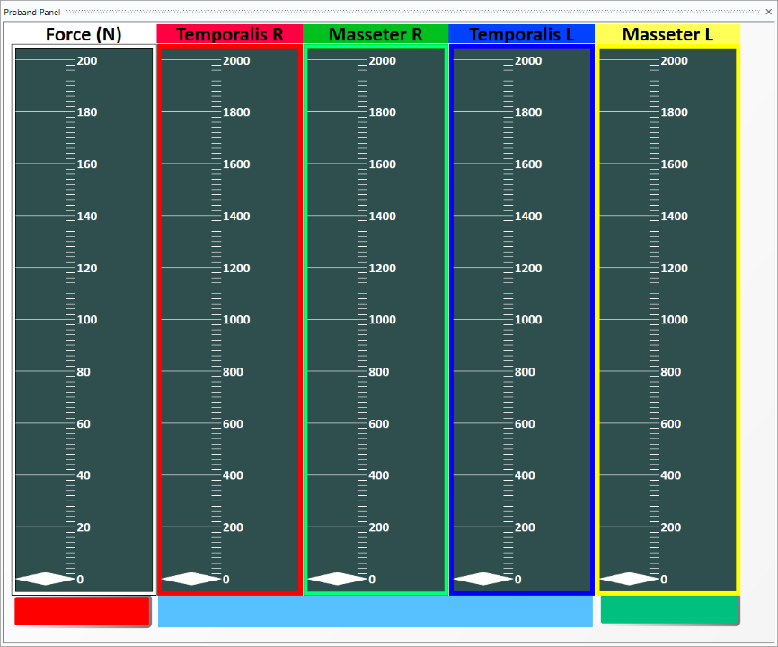

on the proband panel the OnOffIndicator2 and OnOffIndicator3
should always have the same colour. When I make docking - floating this becomes correct again.
Sometimes both colours are wrong but sometimes all color are right
OnOff indicator are alway set at same time same way

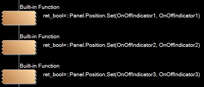

You could try using a Built-In Function (i.e. API) call to refresh the panel. Calling "::Panel.Position.Set(mycomp, mycomp)", where "mycomp" is any object on the panel will force the whole panel to be redrawn.

Hi Steve
What do you mean by a simple programme?
The programme looks very good on the monitor. Many users find the display very nice.
But the programme is so easy and fast writen with FC10.
The OnOffIndicator also work without a Bluetooth device.
Only when starting up, it take 5 seconds longer without a Bluetooth device.
please have a look otherwise i will make an (even) smaller programme

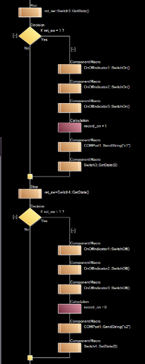

The comand you suggested to move the component to the same location (redraw), did not help.

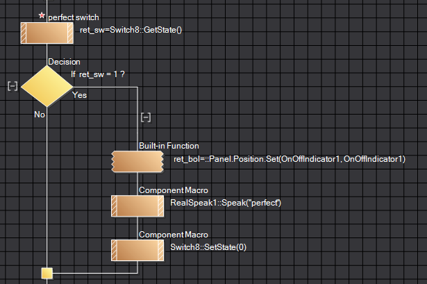

So I thought under the code of the (bad) component is maybe (switch REC or STOP) the wrong time to correct something and copied the comand to an another place under (switch perfect).
If the color is not right and I press the switch perfect , then the color is set corrected again. :)
Please excuse the strange explanation. I keep looking what is going on with the colors

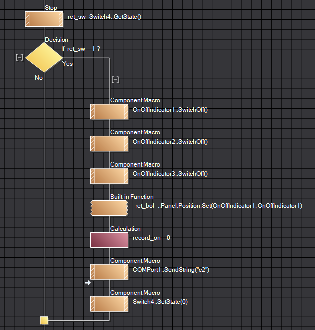

No effect...
if I move the component (redraw) directly after set the color
Set the color correct !
if I press an another switch to move the component (redraw)
FC10_EMG_Monitor_2023_03_01_V1 - with_build_in_function.fcsx
(179.67 KiB) Downloaded 626 times

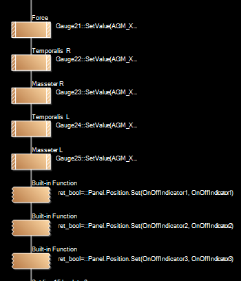

Posts: 1287
Has thanked: 246 times
Been thanked: 257 times
Re: App Developer 2d panel now (or not) redraws
Hi Steve
For my program I found a simple solution.
Every time I change the gauge values (every 200mSec) I do a panel set position of the OnOffIndicator. If they are wrong once, they are corrected again after the redraw.
The last 3 comands solve the problem

Hi Steve
Often the OnOffIndicator was not set corect, but with a "move the poition" it's get the correct state.
For a refresh, set the panelposition of the 3 OnOffIndicator was working in v10.0.4.24 but not in v10.0.4.33
In v10.0.4.33 it's frezz the App. A little strange is that every single command is working and two together also.
But if I use all the three commands together, it's frezz the App. Even though the indicator looks very nice, I will take another one.

Hi Steve
a delay unfortunately does not help

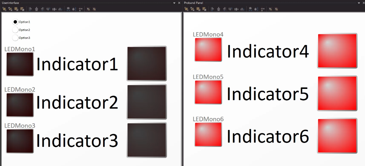

I made a program to test the Led and indicator and the crash (frezzing)
There is the same problem with the signal state even if I use the LED component.
If you run the program, all signal in the 2 panels should be dark or red at the same time.
No matter which screen the panel is on
This also works, but sometimes unfortunately not.
You have to be careful when you use option 3.
It will freeze your flowcode completely (maybe).
