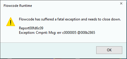

If I let my program run on a computer in the Lap, after 10-20 Minutes I get this error
The program is in the topic
https://flowcode.co.uk/forums/viewtopic.php?f=5&t=1864
An idea what I can do?

Hi Stefan,
Steve may know more but he will likely need to be sent a crash report to be able to help. Is the problem repeatable?

There was no possibility of sending a crash report.
So the program works but randomly the program froze or once the error message came up.
This was on a very good Power PC with WIN10. Of course with a USB BlueTooth dongel.
To test, I ran the program on a HP notebook Win11 pro with additional monitor and there were no (never) problems. (A few long time tests).
I am now trying other WIN10 PCs and other USB-BT dongles.

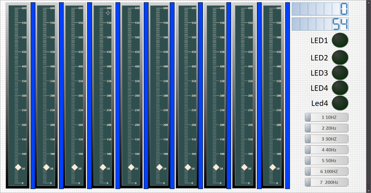

I change my program.
Im not redraw all 200mSec, new I redraw it every Second (1Second).
Then it's working perfect on:
Win7
Win10
Win11
for a long time (more than 5Hours) and it's never crash or frising.
So I wrote a crash test program to set variable redraw time.
And if it's to fast i can provocate a crash.
Crash_Test1_Single_Panel.fcsx
(68.7 KiB) Downloaded 506 times

I use the gauge that can be found under CTRL -Creation.
This is really very good. And extremely practical.
But I suspect that this component is not in the update system (for me). Is there an update for it?
Would it be possible to have this gauge as a "normal" component?
And is it possible to add a command to set scale:
Lower Bound
Upper Bound
Major Tick Step
Minor Tick Step
This would change the scale depending on the sensitivity of the display (gauge)
no updates for this...
Post_Gauge_missing1.fcsx
(12.25 KiB) Downloaded 628 times
Posts: 2032
Has thanked: 306 times
Been thanked: 471 times
Re: App Developer Runtime error
The 2d and 3d primitives under the creation tab are fundamental components that are internally defined within Flowcode and are not components that can be updated via library updates. They can only be updated when the Flowcode "core" is updated.
As with all components, you can use the Component.Property.SetValue Built-in Function to change the values of any properties. This should allow you to change the scale. For example, "dLowerBound" is the property name for the lower bound.
