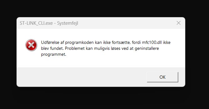

Recently I bougth a new Laptop. I have Installed all FC version Toolchain ect. Everything work, but not the Starm. On my older Laptop 32F042K6 compile the same program and program the device, but not possible on the new laptop?
I have compared on the two laptop the compiler options > Compiler > programmer look similar, and in the devicemanager I can see the the USB virtual port for the device. But I get error, Any idea what could be wrong , please?

I try to do as you said, click on the ST-LINK_CLI.exe, came out with error, System error the same for the other files. I try to uninstall the toolchain and reinstall it again, whitout succes.
then I Googled the STM32 ST-LINK Utility.exe and found this: https://stm32-st-link-utility.software. ... ownloading
Install the program, and ops it worked now
