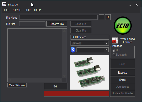

I have found the best way to check the ECIO is first connect the ECIO to the PC via USB.
The LED should be solid lit, is it?
Run mLoader which for a 64-bit pc is located at C:\Program Files (x86)\Flowcode v9\data\tools
That should show the ECIO device:
The LED on the ECIO should flash while mloader is running
