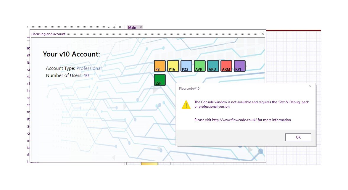

I am failing miserably with the App Developer, I thought I would try to make a list of everything I did so you can let me know where I am going wrong.
And there I failed miserably as well. I decided to use a template, "ModbusTCPMaster" and when I tried to simulate it I got an error "Unknown or missing component ModbusTCPMaster1::ForceSingleCoil". I though this was strange as it was a template so went to do an update but got connection error so that is as far as I got there.
I then changed to SetCoil and that resolved the issue and I could run the simulation. Then I was stumped as I had no idea what to do, I clicked on Console and got an error saying I needed the "Test & Debug" pack or professional version. I did wonder on this as I thought the packs were free now (and it is not in the "Buy" option) but the funny thing is when i went onto Licencing it shows me as professional? and 10 users ??

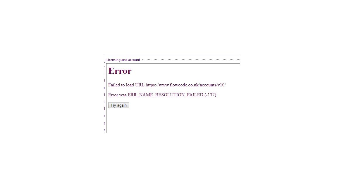

I tried later and then got this error so it appears the server might be down as I can go to other sites.

Re: What is going on with licence (and tempaltes).
Hi Bob.
I have refreshed your licence, so hopefully you can reenter your details and Flowcode will be back to normal.
I have checked and I can enter my licence details within Flowcode v10.
RGV250 wrote:
Tue May 30, 2023 9:34 pm
The Modbus component has been changed since the templates were created, hence the error.
All the templates have recently been updated and will be available as soon as possible.
Even though components are free there are still some packs that require upgrading to the professional version and the Test & Debug pack which includes the console is one of them.
All the additional packs are included within the professional licence and are not available separately.
