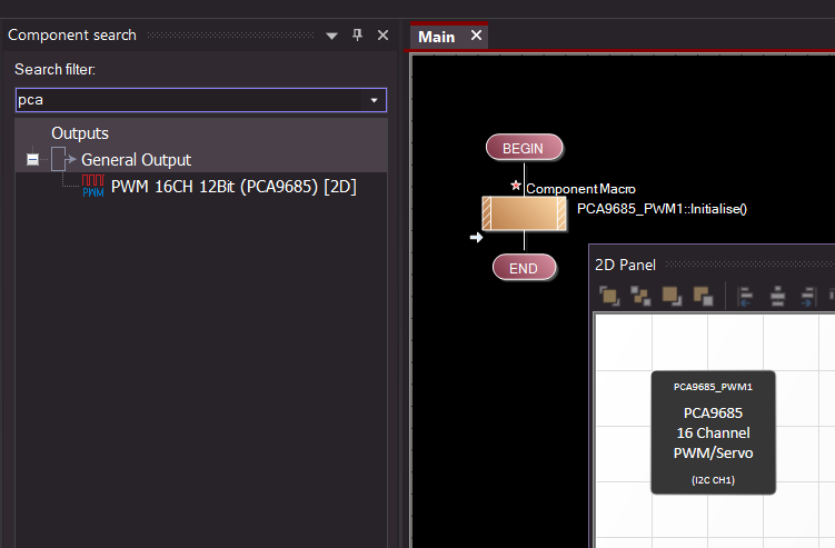

Dear community,
I want to manage 16 PWM with a PIC.
I want to use the PCA9685 but I didn't found any FlowCode code for this chip.
Do you have an idea how to control this PCA9685 ?
Thanks for your help.
Thomas

Hoi Thomas
Type pca in the component search filter and choose PCA9685

Further to Stefan's post above, it is worthwhile remembering to search the "old forum" too as this module has been out for quite some time and therefore there may be helpful posts in there.
