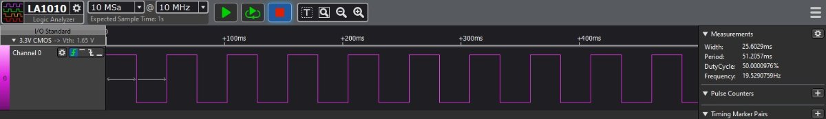

I've been playing with a Pico when I get time, and there is an issue with the PWM.

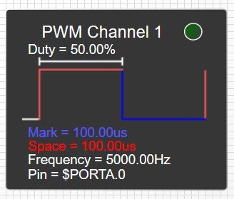

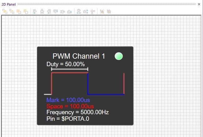

If I set it for a frequency of 5KHz then I get an actual frequency of 20Hz
Analyser PWM=20Hz.jpg (30.63 KiB) Viewed 3121 times

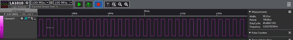

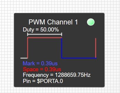

Experimenting, if I set the component for a freqency of ~1.288MHz the I can get 5KHz.
Flowcode PWM=1288659Hz.jpg (27.88 KiB) Viewed 3121 times
PWM=5KHz Analyser.jpg (37.08 KiB) Viewed 3121 times
