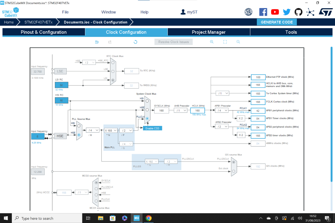

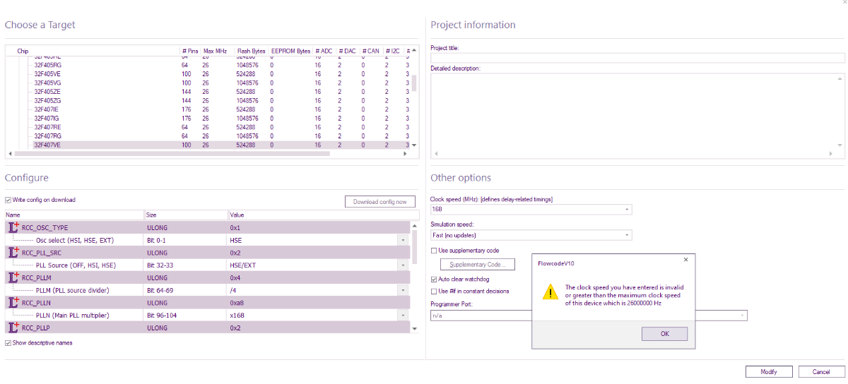

When setting the various clock parameters for the STM32F407VET6 against STM32CubeMX, for a system clock frequency of 168MHz, the clock speed setting for Flowcode delay-related timings complains that 26MHz is the limit for this device.

If my memory is correct, which it usually isn't these days :roll: that refers to the input clock speed (e.g. crystal) for STM32 targets.
I'll try and remember to check when I'm back home at my Flowcode PC.
edit: Yes, confirmed as true, this value refers to the input frequency (8 MHz in your case)

Perfect!
Thank you Leigh - Greatly appreciated!
(coding ahead of hardware to play with)
