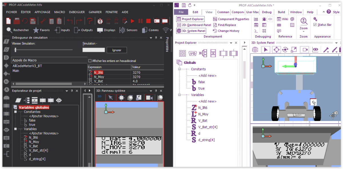

hello,
can you tell me how to change font of LCD screen. The information is much less readable than with flowcode V7.

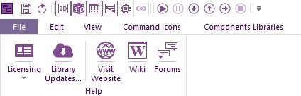

Is there a possibility to have the "auto-hide" tool of version V7 very useful?

Thanks for letting us know.
The LCD font should not have changed between v8 and v9 so I have reverted this back to the old classic font from before.
The latest file should now be available from the Help -> Library Updates menu.
Let me know how you get on.
I will try to add this back in and it will hopefully be available in the next core update.

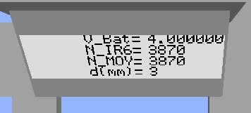

Thank you matrix!

Another request: could we have the possibility to save the customised menu to import it on student PCs?
There's no way to load and save this QAT (Quick Access Toolbar) data from Flowcode.
However, the customisation data is saved in the Windows registry and you could apply the settings to the students' Windows accounts automatically (by copying the data from an account with the settings you want). The location that stores the QAT customisation is here:
[HKEY_CURRENT_USER\Software\MatrixTSL\FlowcodeV9\BCGPRibbons\BCGRibbonBar-59398]
But you should not attempt to do this unless you are comfortable with editing the registry because very bad things can happen if you do the wrong thing!
