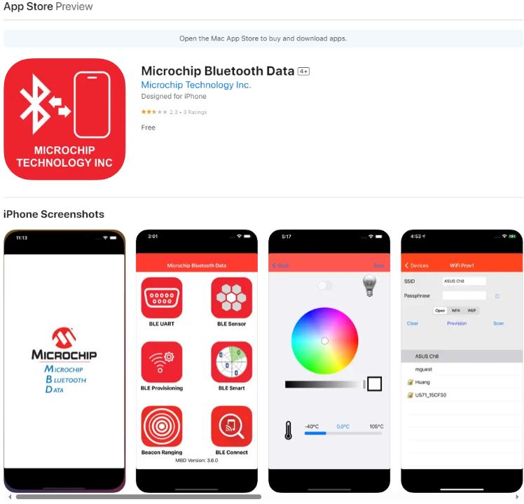

A long time ago I used Microchip App for BLE on my mobile phone to test BLE.
In that time I also used a Microchip BT Device.
I also remember another BLE terminal program.
But unfortunately I changed the mobile phone.
I'll see if I can still find it

That looks good - nRF Connect is rather utilitarian but does work on android or Windows..
The android app is actually better than the pc version.
