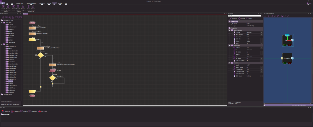

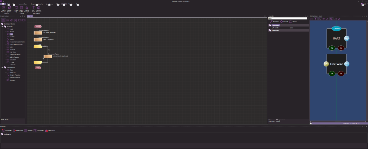

hi guys, tell me what I'm doing wrong. I need to connect two microcontrollers via 1wire
kersing
Posts: 194
Has thanked: 81 times
Been thanked: 65 times
Re: 1wire_help
Post by kersing »
Please post your flowcharts, not screenshots that are unreadable.
