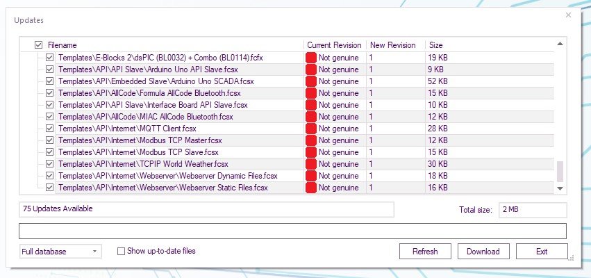

I opened a couple of downloaded files and get a message telling me it has been created in a newer version and may not run as expected or something like that.
I do an update and get a load of updates but it says they are all not genuine, the strange thing is that when I restart as instructed the same updates are still there.

Are you running the latest version of Flowcode - i.e. v10.0.4.33? I think it was fixed in that release.
One of the fixes listed in this page relates to this:
  • Fixed tamper check on *.fc?x library files (e.g. allows Templates to flag as genuine)

This may seem like a stupid question but where do i find the version and how do I update it. I have looked all over the place and apart from knowing it is V10 I have no idea.
I have just read the link and I do have "check for core updates on launch".

If you click on the purple question mark in top right you should get your version number.

I am on 10.0.2.21, I have just seen the box to update so doing that now. Might I make a suggestion and show this box in the middle of the opening screen when opening as I had not noticed it before.
