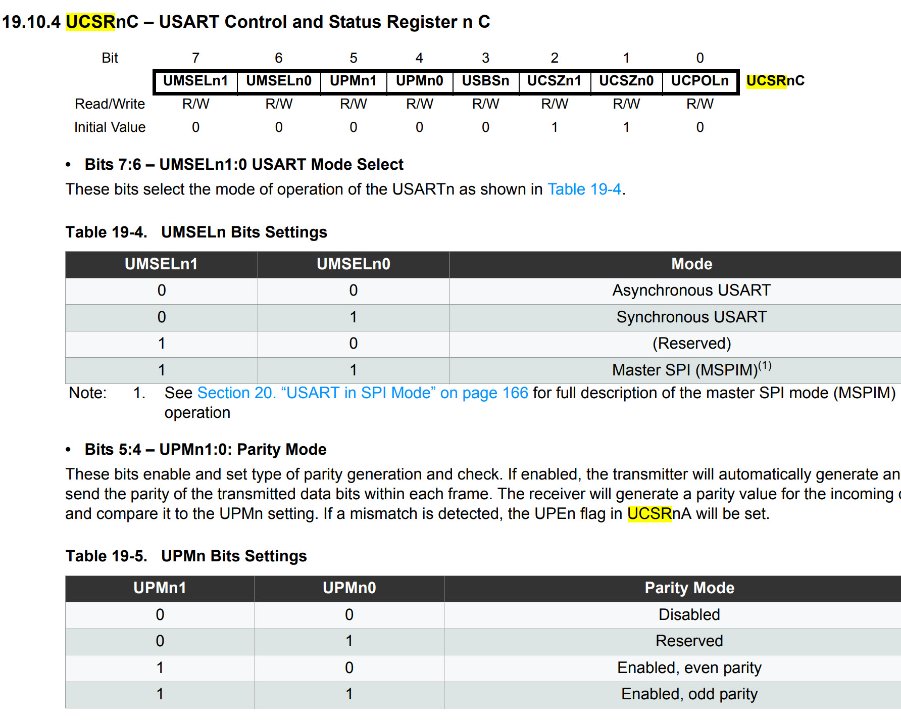

Found the following on the web but don't know how to implement for flowcode
seems that register UCSR0C is responsible for parity but don't know how to .

From the datasheet:
So you need to set bits 4 and 5 correctly,
UCSR0C |= 1 << UPM01; // Set UPM01 to 1
UCSR0C &= ~(1 << UPM00); // Clear UPM00

Hi Martin ,
Thanks for your fast reply , so I put the 2 lines in a c code
and put it after INIT uart is that right ?
I try it and let you know
Thanks again

Maybe - you'll probably need to check the UPE flag in UCSR0A to check for errors? If it works :-)

Hello Again ,
It works perfectly !! :)
Thanks so much for your help
