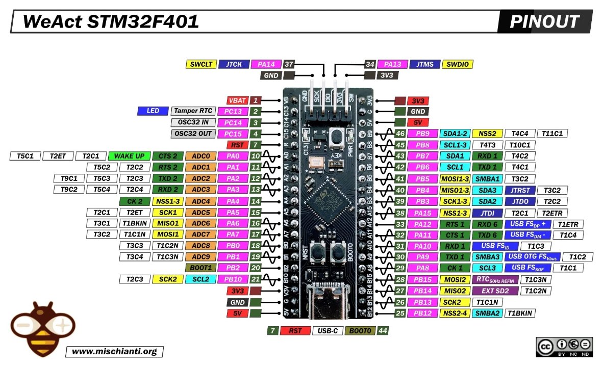

I am trying to use the below stm32f401rc Dev board for my Project so first thing
I try to make c13 blink, the chip will program ok but no blink , nothing is working
any idea what the problem can be ?

The board has a 25Mhz oscillator so I entered in 25
I also tried to compile wilth 10MHZ but same result
The board comes programmed with a variable PWM on
C13 so the board is not defective.
