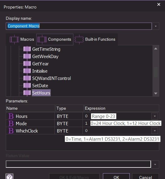

when I try to set the 24 hour value (rtc module default format) to 12 hour format.
specifically to change from 0:00 format to (12 hour format), which should be (12:00am), as shown below.
00:00 (24 hours format) = 12:00 am (12 hours format)

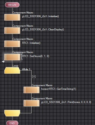

Using the following logic schematic loaded into the microcontroller as shown below.

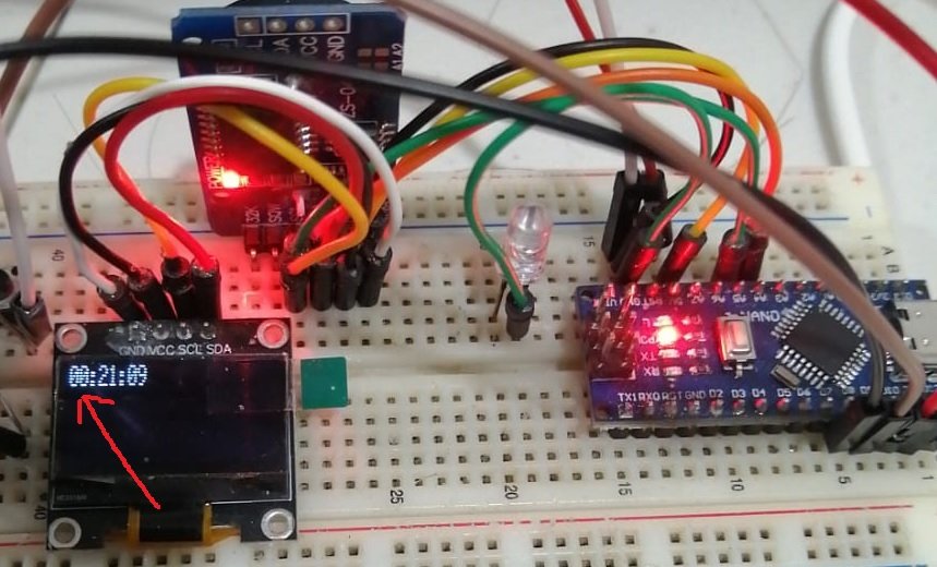

After loading it into the microcontroller, the logic that follows is
wrong --> 0:00 (24 hours format) = 0:00 am (12 hours format)
correct --> 00:00 (24 hours format) = 12:00 am (12 hours format)
RTC component macro set for 12 hours does not work correctly
