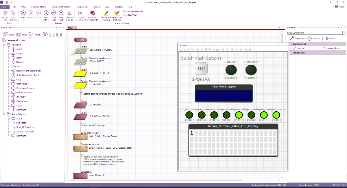

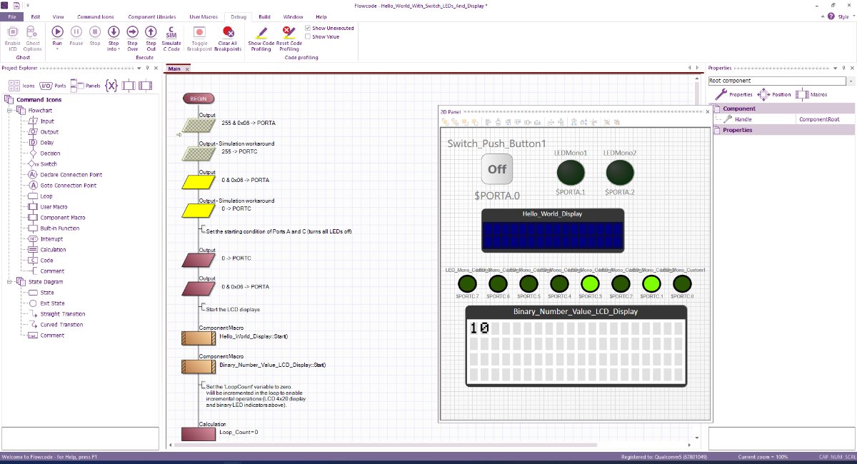

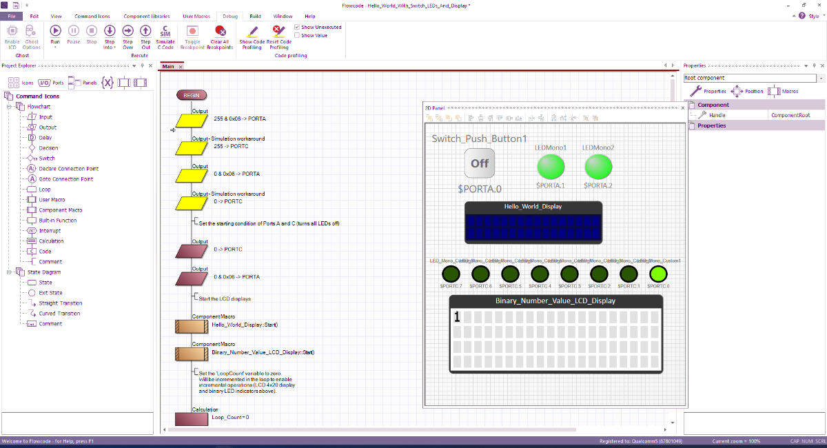

I provide three screenshots which include the start of the program...
1st simulation run with port initialisation icons enabled and fudge disabled. Allowed to loop-count to 10.
2nd - Simulation stopped, then restarted, and stopped at loop-count of 1, showing LED persistence from previous run.
3rd - Simulation re-run with fudge icons enabled.
Certainly something going on between PC speed/run-time timings and the dashboard, where the dashboard isn't always getting initialised before the debug simulation starts to run. This is obviated further by slowing the simulation down.

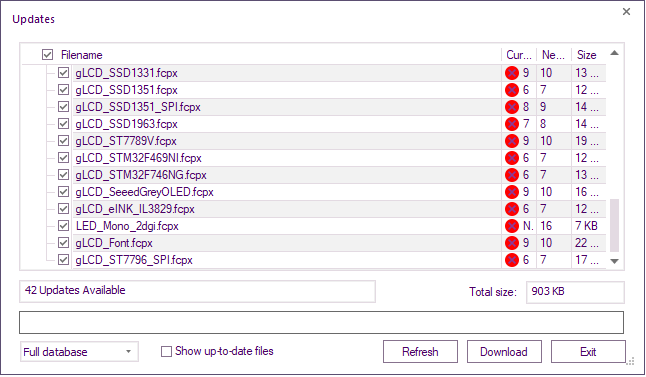

Can you select Help > Library Updates.. and take a screenshot and post the Updates windows, please.

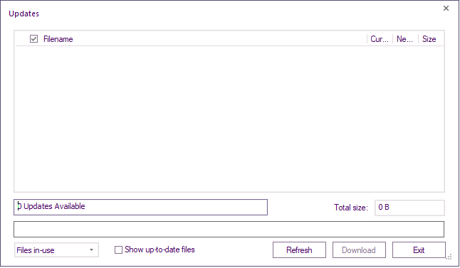

Re: 2D Dashboard running simulation
Hi Martin.
I provide the requested screenshots...

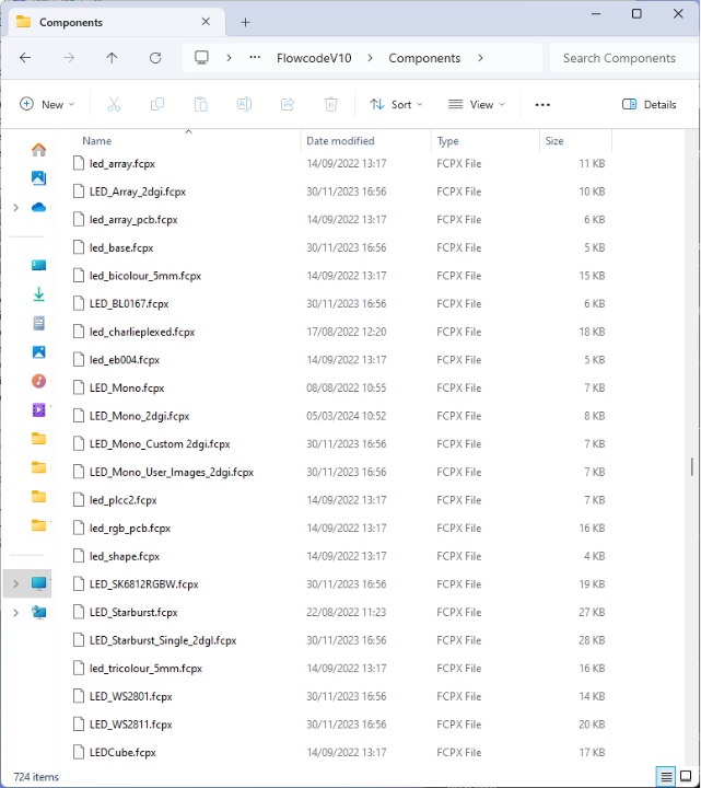

"Files In Use" reflects no updates, although "Full Database" does, and also double-checked the correct location of the replaced file (reflected by file date). Just to confirm, I have closed and re-opened FC a few times since replacing the file.
Hopefully this may be of some help.
Thanks and best regards,
Brendan
