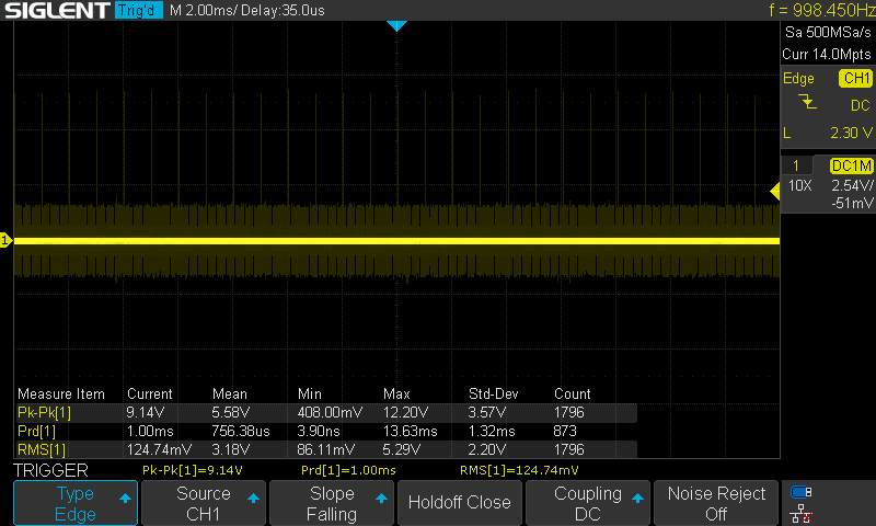

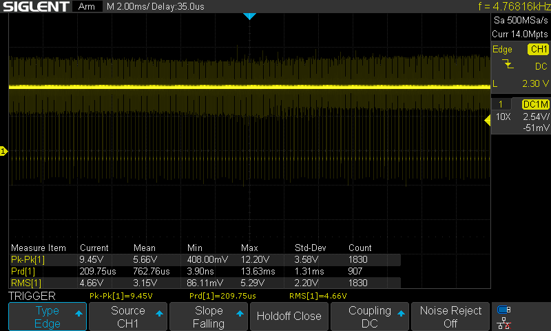

Re: DQ542MA Stepper Driver
Hi Leigh,
Thanks for the response, please see attached Scope Plots
SDS00006 is the FC and SDS00007 is from the Arduino Code - looks like the FC is inverted to that of the Arduino Code?
Regards,
Gavin
Did you change the delay to 1mS?
Using the oscilloscope, can you see the 1mS pulses out of the Uno? And the direction change?
If so, the Flowcode project is working as it should. If not, then we need to get that working first.
If the stepping pulses are seen...
What is the motor doing? Any sound?
Does the driver board have an enable signal input that needs setting/driving from the Uno?
Hi Leigh,
I do see it change, only issue the amplitude of the FC is way smaller to that is the Arduino code.
The motor is doing nothing, no sound neither.
I have also connected the enabled but I see it should be connected to GND, I have changed the FC to suite, please see attached.
Regards,
Gavin
Regards,
Gavin

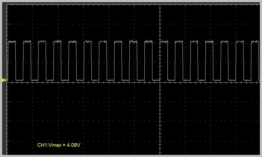

I have placed some delay as Leigh has mentioned in your flowchart to test the PIN operations and Voltage levels,This is all working fine ,
I am thinking you should carefully think and code the stepping sequence ,
On my Chinese UNO (Clone) your modified FC chart produced this wave form
This is your modified FC Chart (this is in no way correct it only test the HW and for stepping the motor you need to redo the cart
Hope this helps you in any way
