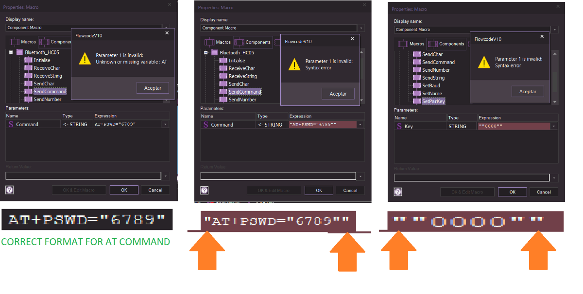

*send command macro
and
*set pair key macro
don't works.
here you have an example of at command structure to verify the correct syntax:
ejemplo at comand.gif (2.86 MiB) Viewed 3330 times
correct syntax is not possible to add.
AT COMAND PROBLEM.png (165.29 KiB) Viewed 3330 times

command to change name works!! so, the communication between micro controller an Bluetooth module its OK!!

If you need to send quotes within a string you can use a backslash to escape it,
So your correct command translates to “AT+PSWD=\”6789\”” in the expression box.
